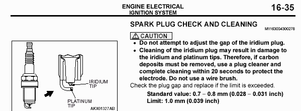

Old Apr 25, 2004 | 08:23 PM
jemm's Avatar
Joined: May 2002
Posts: 719
From: Jamaica.

Old Apr 26, 2004 | 06:38 PM
mikesevo8's Avatar
Posts: 1,078
Likes: 61
From: Ulster County, NY
Originally posted by rt turbo
i gapped the plugs down to .027 and the miss is gone! but it still feels a bit laggy, but its much better than before. also, im having trouble getting it to boost up to 20 psi. i have my greddy e-01 up to 65% and it wont go over 19.4 psi. any ideas?
Have to remember that our ignition fires 2 plugs at once, so the gap is narrower
than normal.
