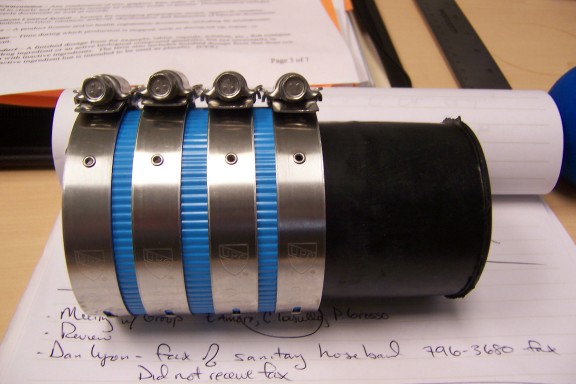

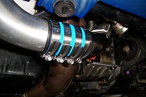

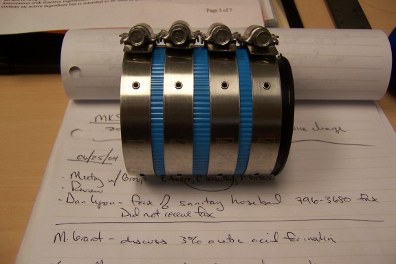

well i went over some things again (at work ) i am a boss so i dont care and all my work was done. Anyways after speaking with Jarrod he asked me if I had placed the gasket on the BOV correctly. I thought I didnt, but after taking if off again and seeing that I had actually put it in wrong. I had the rubber gasket material facing the BOV instead of the pipe. I doubt that was the serious leak but we will see. Also, as far as that coupling, my friend here at work just gave me a KICK *** coupler specifically made for plumbing that will hold up to 130psi. Here are some pics. The cool thing is that the clamps are fastened to the coupling so they dont slide. Check it out.....
Also, here are some pics of my boost gauge with the car off, and with the car on...you can see it is busted. So i ordered a defi d gauge black face and had it overnighted
