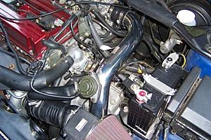

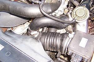

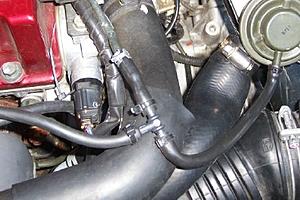

where do i tap for vacuum? the new buschur pipes did not come with the little nipple that the oem did on the lower IC pipe.
also i have a 03 model and the driver side braket on the IC did not fit
im also having a hard time getting the hose from where the stock Dv was to the new 1g DV it seems that the 1g is pointing down too far and the hose has to be bent( crimped) to get it on.

i will take some pics for you to show you better
Old Jun 27, 2004 | 12:40 PM
  #72
SuperchargedGTZ's Avatar
Joined: Feb 2003
Posts: 946
From: Gilbert, AZ
here ya go
Attached Thumbnails Need Immediate Help....Buschur FMIC problems-bov-connected.jpg   Need Immediate Help....Buschur FMIC problems-vacuum-lines.jpg   Need Immediate Help....Buschur FMIC problems-piping-small.jpg
Old Jun 27, 2004 | 04:47 PM
  #73
Stock's Avatar
Posts: 85
From: New York State
thanks man that helped me out
