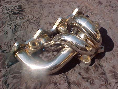

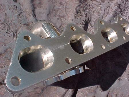

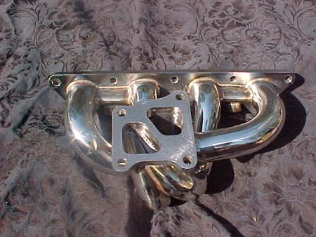

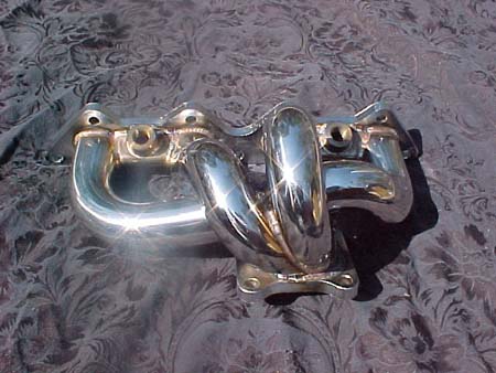

From: Austin, TX
Originally Posted by atlvalet
Zeus,
What kind of manifold are you using? I was thinking of going with DNP...
I have the SS Autochrome...
http://www.stockreco.com/Mvc-EVO1f.jpg
http://www.stockreco.com/Mvc-EVO3f.jpg
http://www.stockreco.com/Mvc-0EVO04f.jpg
http://www.stockreco.com/Mvc-EVO2f.jpg
compared to the DNP...
http://www.dnperformance.com/images/...nifold17_s.jpg
http://www.dnperformance.com/images/...nifold19_s.jpg
http://www.dnperformance.com/images/...nifold03_s.jpg
http://www.dnperformance.com/images/...nifold02_s.jpg
They appear to use the same manufacturer with the SS being about $200 less expensive.
Old Aug 10, 2004 | 09:21 AM
  #70
Erik@MIL.SPEC's Avatar
iTrader: (94)
Joined: Dec 2001
Posts: 5,695
Likes: 24
From: Los Angeles
Zeus,
They appear to be SIMILAR...to my eyes anyways. Check out the bosses. The ones on the DNP seem to be less thick. Also, the DNP's welds aren't buffed out, whereas on the other they are...Maybe it is the same, I don't know.
Also, is there a link on where to buy the cheaper one? THanks.
Old Aug 10, 2004 | 10:37 PM
  #71
Zeus's Avatar
iTrader: (66)
Joined: Aug 2002
Posts: 5,454
From: Austin, TX
Upon closer inspection, you're right about the welds. However, looking very closely at mine, the welds are in the exact same place (same lengths of tubes used). Also, the two different pictures with the bungs present an illusion... they are the same size it seems.
