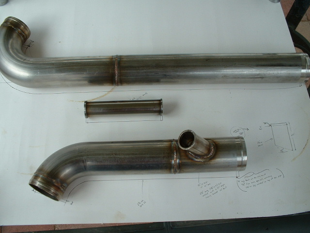

I finally finished my custom upper IC pipes to go with my custom IC. Check out the before polishing and after pics.
I have it set up as a straight shot, (like Buschur's), but I wanted to use my Turbo XS H34 BOV and have it still recirc. It will sit upright from the 1 1/4" pipe, and I made a spacer to take the recirc back to my HKS RS.
I still waiting for a 2.5" hump hose to complete, should be here next wed.
They are made from 2.5" 16g stainless steel.
I will probably just order the AMS lower IC pipe, because It's pretty much what I need and I can't make it myself for what they sell it for.

I have the plans, but my measurements are for my custom IC, relocated mini battery and HKS RS intake.

Very nice. I was afraid of what I was gonna see when I first opened this thred but you suprised me. Does someone you know have a Bead Form tool or some kind of bead rolling machine?
