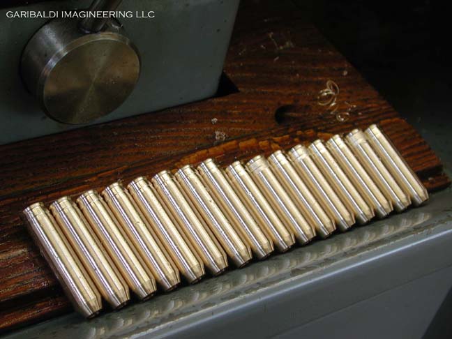

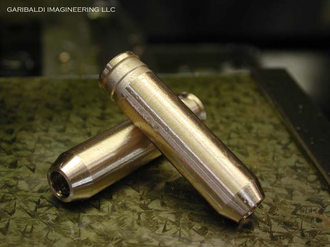

Maganese bronze valve guides I made for Evo head.
They have a tapered end, revised seal retaining lip and are .100 longer than std to give more support to those itsy bitsy valve stems on these cars when they run high RPM and high lift cams.
