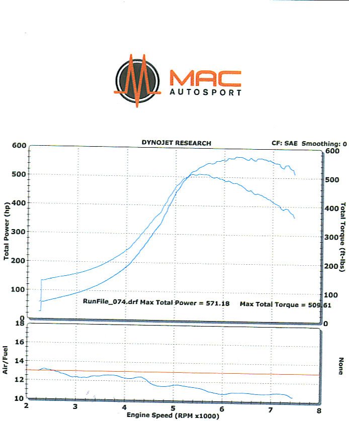

Dyno of my Evo at 26psi of boost running C16. Notice the torque and quick spool. We're increasing the rev limit to about 8k and bumping boost to between 30-32psi. Should be awesome. A cage gets installed in three weeks so I'll be able to run at the track. I've been once and got the boot.
