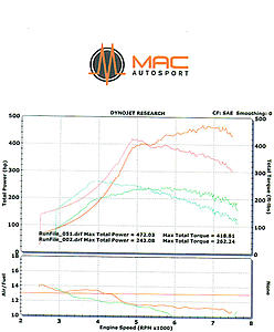

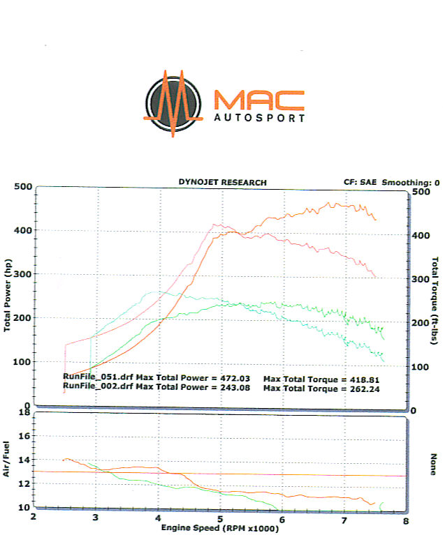

3240, perhaps it's the HKS turbokit that's hurting your spool up. Because here's a chart of the AMS 2.0L on a large GT35R, his dynochart (not the real world) indicates faster spool-up than yours. Bear in mind Al had the same turbo as you and added 150whp and improved his spool-up with the AMS turbo.

1. He's running 39psi vs my 26psi.
2. At 3,500 RPM's AMS is making about 140 whp, I'm making about 130whp. But, AMS is only making 100 ft/lbs of torque while I'm making almost 200 ft/lbs of torque.
3. At 4.500 rpms's AMS is making just over 300 whp while I'm making about 290 whp. But, he's only making just over 230 ft/lbs of torque, while I'm making 330 ft/lbs of torque.
4. At 5,000 rpm's AMS is making 500 whp and I'm making 450 whp. But, he's only making about 390 ft/lbs of torque while I'm making about 480 ft/lbs of torque.
5. After that his 39 psi kicks in and I'm toast!
In addition to increasing spool up time a stroker is supposed to add low and mid range torque (mission accomplished.) It will be interesting to compare these charts when I increase my boost to about 30-32psi but not AMS's 39psi. What has AMS done to their car that allows them to run 39psi? That's incredible!
I do agree that AMS makes an awesome turbo kit but it wasn't available when I began this project. However, I am pleased with the HKS kit. If I had to start over would I have bought it over AMS? No.
Keep in mind that I'm in Colorado when you compare my spool up to anyone at sea level. Also, Al ran an HKS 3040, I'm running an HKS 3240 which is slightly larger.
Thanks for the link. The AMS car is impressive.
