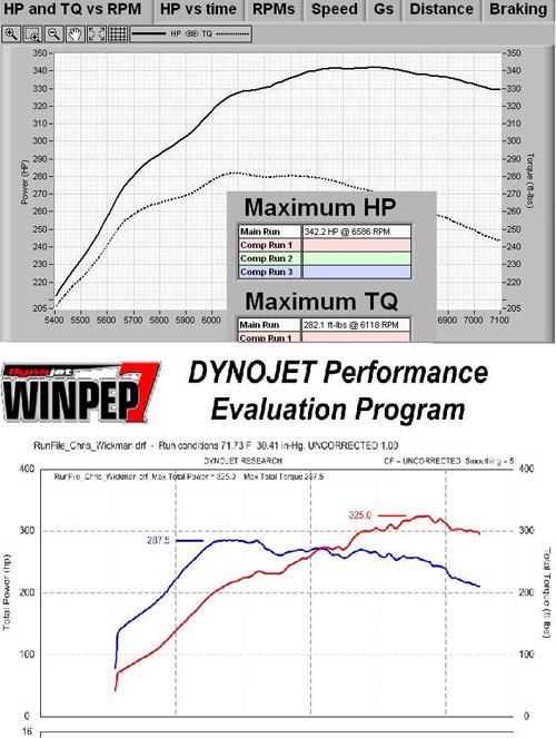

Originally Posted by Mercenary3
Those power/torque plots are somewhat consistent. Any idea how accurate they are compared to a real dyno???
I dyno'ed at 325 to the wheels. with lttile airflow thru the front end. Temp around 80 degrees.
I made the g-tech run on a night with the temp around 40 degrees. With my intercooler sprayed down to cool it. How much extra power is the colder temp all that worth???? I Dunno. Here is a rough comparison:

k270kmh's Avatar
Posts: 1,041
How are you considering the total vehicle weight?
Old Mar 30, 2005 | 10:42 AM
Cajun Power's Avatar
Posts: 1,179
From: Lafayette, LA (Da Bayou)
I used GVWR not curb weight. My bad. I looked at the sticker in the door. I will have to adjust the weight.
OK, so about 15 hp above with the colder air. Seems somewhat close. IDK if the air is worth 15 hp but at least the colder run is above the warmer one. Seems to correlate at least.
