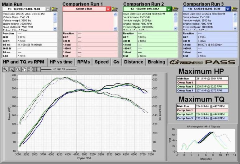

Smile Gtech Pro RR runs
Playing with my new toy I got for xmas, got out and did some runs my new Gtech Pro RR while the snow is melting. These are all 2nd gear pulls. Didn't do any 1/4 mile times yet, waiting till I drive out to my deserted flat road waaaay in the country. I was pleasantly surprised how well the Gtech was to use and set up. My car is bone stock. I had my car as being 3500lbs with me in it. (220lbs, phat bastard.) All in all I think pretty accurate considering wind resistance.

how in the hell you got 2.75 sec 0 to 60
Old Dec 29, 2004 | 09:04 PM
plokivos's Avatar
Posts: 4,902
From: Atlanta
that's 60 ft

These runs were just for getting a good second gear pull, so I only took it to 4k in first gear, hence the 7.xx 0-60Mph times...

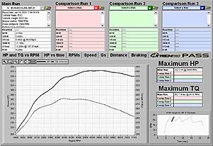

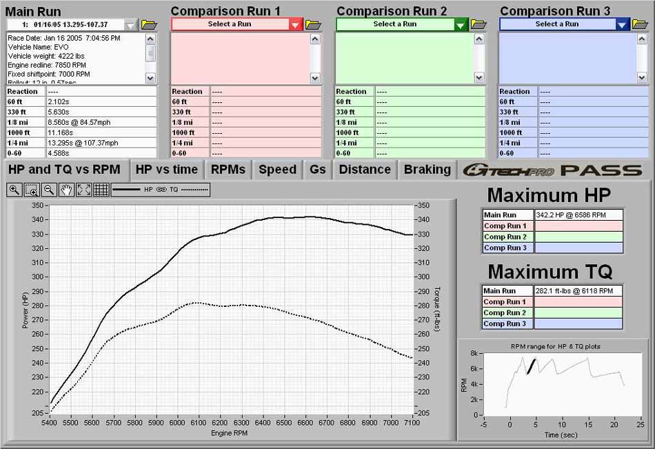

Here is one of my pulls...

Smoooooth.... But I think you need to re-adjust te G-tech for your car's weight. There is no way you are 4222 pounds, that's the maximum capacity for the car. I calculated out my weight to be 3550 with me in it (220 pound in current trim) I have the sunroof as well. Best thing to do is to go to a scale to get a really accurate reading...

0-60 in 4.5 seconds.....yeah you didn't rev it to 5 grand and dump it
