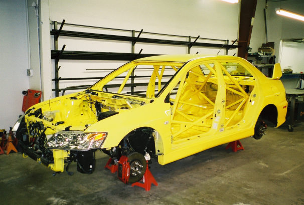

^ What I'd worry about that roll bar is that there aren't enough attachment points to ensure that it wouldn't just punch through the floor in a roll-over type accident. It would be better than not having anything, but I wouldn't bet my life on it.
Here's what a real cage looks like:
Attached Thumbnails rollcage question-0246311-r1-043-20_19.jpg   rollcage question-0246311-r1-051-24_23.jpg   rollcage question-0246311-r1-053-25_24.jpg

Yup, thats a real rally style roll cage. These other ones for sale are for occasional track days or added protection. Yes, if the cage wasn't bolted down or anchored in the proper spots, it would just puncture right thru the car or end up bending and hurting you badly. If I were going the rally route, I'd get some nice skid plates covering the bottom of the car too.

You should explain in more detail why you want to have a roll bar or cage in the car. Some organizations will allow a removable link here or there but all pretty much require the main hoop and forward bars to be permanently welded or bolted to the chassis. This is not a simple undertaking.

I see no cross bars and the front bar has bends in it.
That would probably hurt you more from folding on you in a accident then if you didn't have it at all.
