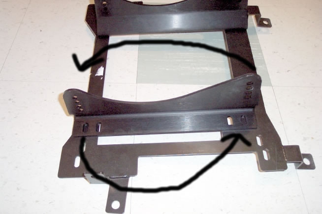

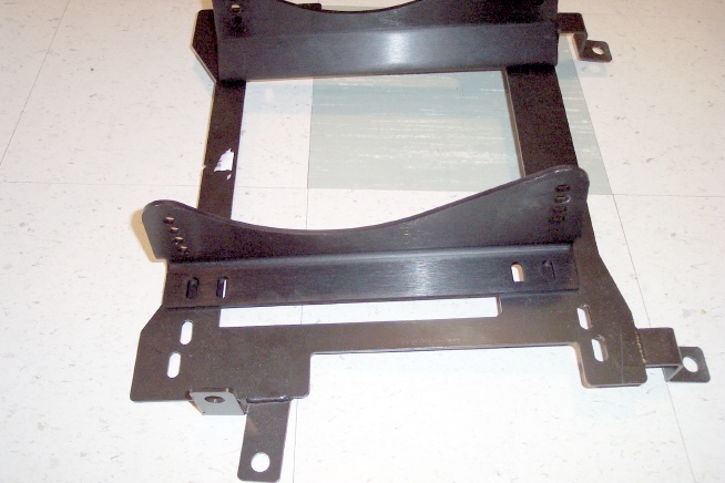

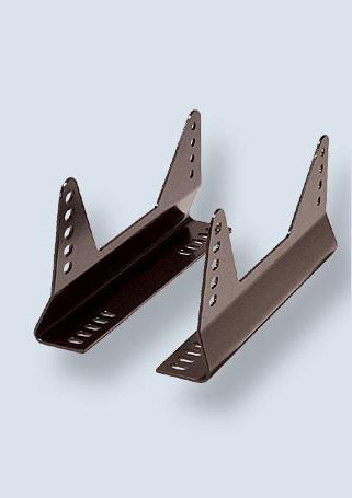

I got the Sparco Evo, Evo-specific base and aluminum side mounts.
There's a bit of a problem that the holes in the base don't line up with the side mount holes, they're too far apart. My guess is that Sparco didn't intend for the base to be used with a race shell but Ben at RallySport Direct said the Sparco they have mocked up in their showroom lines up perfectly, so I'm not quite sure why mine didn't. No biggie, it's just a couple of holes that need to be drilled.
If you run into the problem I did, you can drill the base to accomodate the side mounts, but my guess is if you're over 6' tall, you're going to need sliders to get the seat back far enough. There isn't a lot of wiggle room in the base material to drill holes very far back.
Impressions on the seat: It looks just beautiful, and even though it's lightly padded it's quite comfortable. I'm 5'10"/175, and it fits me like a glove. If I ate one more DQ Blizzard it might be a little tight. I did a quick weigh on the bathroom scale (supposedly the scale is accurate to +- .5 lbs) and the Evo came in at 17.5 lbs, which is close the reported 18 pounds in the Sparco competition catalog, and no where near the 15 lbs reported in the Sparco tuner catalog.
I'm attaching a couple of really poor pics to illustrate the side mount/base issue, and I'll post up some good pics of the seat installed after I put it in tomorrow and any revelations once it's in the car.

i wrote a thing on this a long time ago... sparco uses their universal mounting base which tehy drill holes for side mount seats. bottomline is you either drill... or get adapter bars made to get your holes to get closer together.

Ok looking at your pictures There is one thing that catches my eye. In the Both picture you have the side mounts 180 degrees out of wack. You want them facing so the "Sparco made in italy" can be read with the seat attached to the base. That should fix your alignment issue.
I have a Prodrive(same as corsa)hooked up to a evo base(I know blasfamy) and it lines up perfect. If you need me to snap some pics let me know.
Ben

Yeah, snap some pics, I don't see how you can get it to line up without drilling.
If you look at the second pic, even if i use the holes that are closer together on the base, they're still too far apart to match the holes in the side mount.

RallySport Direct:
Do you have steel or aluminum sidemounts on the ones that fit correctly? I'm starting to think that the steel sidemounts might match up, but the aluminum ones don't.
It's tough to tell from these attached images whether there are any differences in the dimensions from the aluminum to steel side mounts.

Originally Posted by nubby
RallySport Direct:
The aluminum and steel side mounts are the exact same size and shape. So if the aluminums do not fit neither will the steels.
Here are some pictures of how it should be set up.
Hope this helps.
Ben

I am affraid that we are not understanding each other. Which is the trouble over the internet sometimes
From the pictures you posted you have the sidemount installed backwards.
You need to flip the sidemounts around like so
So the side mounts look like so
This will fix the problem of the holes on the base not lining up but it will not fix the problem with being to far back. You will need sliders or a custom base to fix that.
Ben

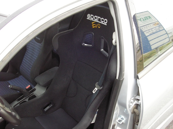

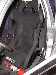

Sparco Evo v.s. OEM Recaro
Well, you can kinda see the difference between the stock seat and the Sparco Evo in this pic. No real comparison between how these hold you.
Custom bracket is getting fabbed today, so I'll try and post some more pictures of the whole shootin' match.

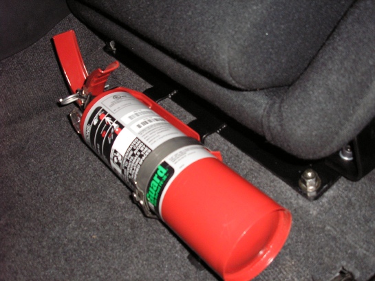

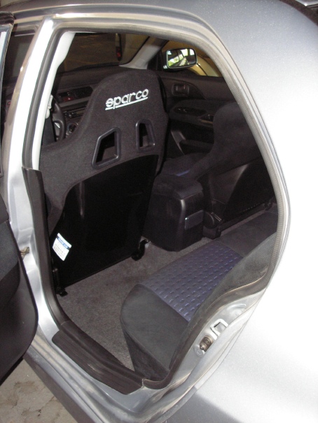

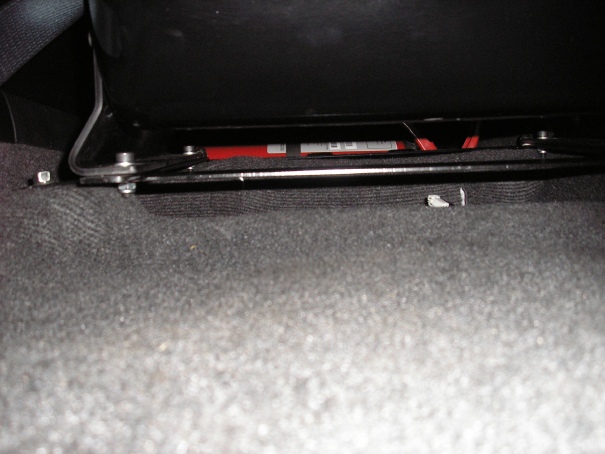

Here's some pictures with the custom seat bracket installed.
