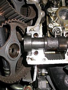

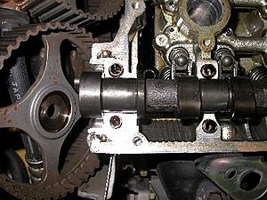

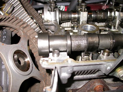

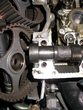

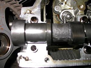

Greg- I didn't call you this time because it was the customer who bought the cams not me i only did the installation. I'm not interested in doing you or your company any harm and as i told before i'm not a whining ***** and you did get my $ back after 5 phone calls and about a week after you received them but please be honest there is no way you could have fitted that 264 ex cam i sent you back months ago without cutting the excess of material it had to make it clear.The pictures talk by themselves. And about the lube thing are you just trying to make me look like a moron? There is no lube that can make a defective cam fit in place. We did not installed the cams thats why there where no lube in them as you can see in the picture the intake cam is the stocker we only test fit on that one.
As i told before when the cams get measure up we will know what happened and if i'm the one who committed a mistake i will admit it and post here.

Attached Thumbnails gsc cams nightmare-gsc6.jpg   gsc cams nightmare-gsc4.jpg   gsc cams nightmare-gsc5.jpg   gsc cams nightmare-gsc7.jpg

what exactly is wrong with the cam? It's difficult to tell from those pics
also, how did you remove your gears and timing belt that the gears are hanging so low and so loose?? When I removed my gears, i had them ziptied in about 3 places with a bungee cord holding them up to ensure that no teeth shifted...
just curious...not saying you are doing it wrong or anything
