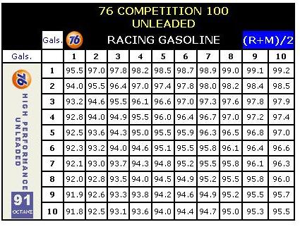

That table only addresses octane. It does not address specific gravity. Most pump fuels have a specific gravity of around 0.76. 76's web page indicates that their 100 octane fuel has a specific gravity of 0.744. The addition of the 100 octane fuel's lower specific gravity would have meant that the car was running richer than it would have if they had just put 93 octane fuel into the tank.
As well, if they didn't drain the tank and precisely mix the fuel, who knows what they ended up with. It is very hard to guage the amount of fuel that is left in a gas tank.
Originally posted by SRD
You mean lean out the a/f ratio.
No, a lower specific gravity fuel will flow more fuel through an injector at a given pulsewidth than a higher specific gravity fuel. That means that the car will run richer in open loop mode.
I see this every time I put 117 octane VP C16 race fuel (0.73 SG) into my car. I have to lean the car out at least 13 to 14% to get it running right as compared to 93 octane pump gas.
So it is possible that the addition of the 100 octane fuel did make the car run richer than it would have on straight 93 octane fuel. So the knock went away as compared to the 91 octane, but running richer means that you loose power. There was a net gain, but perhaps it would have gained more on straight 93 octane pump instead of a fuel concoction.
