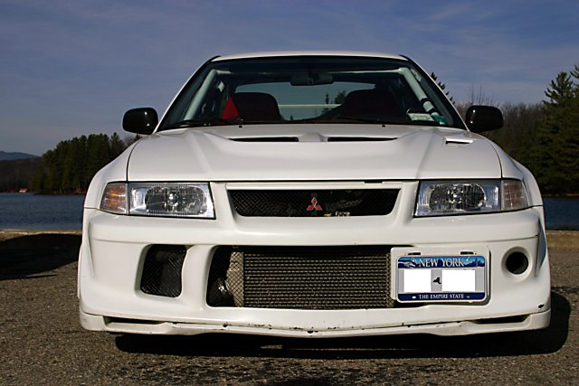

evo 6.5
heres some pics over the summer hopefully they work
Attached Thumbnails evo 6.5 emission problems-novcruise2.jpg   evo 6.5 emission problems-novcruise4.jpg
