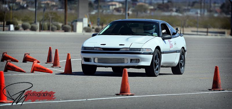

It's no mystery. It's because they are now over 20 years old, can be picked up for less then a grand, and go very fast. Your usual DSM purchaser is not the type of person that will do maintenance and properly care for their car.
I've had my 1g since 2003 and it is an extremely reliable car. If you take the time to build it right, DSM's will love you for a long time in return. Wait until the EVO's 8's and 9's have been modified, romped on, and sold off (for cheaper and cheaper each time) for 20 years. They will end up just like the DSM's of the 90's.
Really this discussion was about the differences between the 4G63 motors, at least I thought. But since we are talking about DSM's, here is mine:
