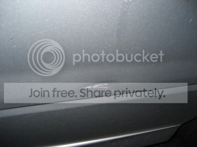

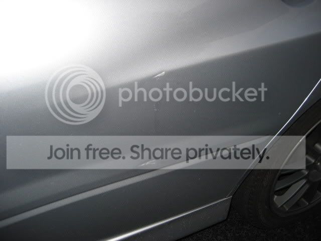

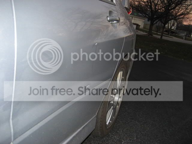

last night went to target w/ the wife - pager alarm went off - went to check it out and found this:
w/ no one to blame...asked security if they possibly might have gotten the people on camera...filed a police report and awaiting word to see if they possibly seen the culprit...

touch up paint would work, but it wouldn't look good and the dent would still be there. I say take it to a good paint shop and have your insurance pay for it.

Call a reputable paintless dent removal shop. If paint is missing you will need to repaint. However if it is just scuffed you might be able to take some rubbing compound remove the scratches, and then get the PDR guy to take out the dent.

I would pay out of pocket instead of going to insurance. From the pictures it looks as though their paint went on to your car which is easy to remove. A dent remover will easily fix the dent. Maybe $100-150. Sucks it happened to you though

PDR for now and get it painted. Don't take it to a body shop until the dent has been removed. PDR (by the right person) is far superior to any kind of filler.
That bottom one looks like it may be pretty tricky, cause its on a bend line. However, a good PDR person will tell you straight up if he thinks he can do it or not.

I would definitely go with paintless dent removal, it doesn't look like any of your paint is messed up (only transfer of the other car's paint/plastic onto yours - which can be removed by buffing).
Now, if you take it to a shop, they'll repaint your whole door and then it won't match the rest of the car.. AND charge you more than PDR.

the quote is a shop quote...i'm afraid that my poor quality pictures don't show the fact that there is some significant paint scrapage which has been mistaken for the other car's paint...would i be better going to a mitsu dealer? esp if i'm going to be paying that much?
