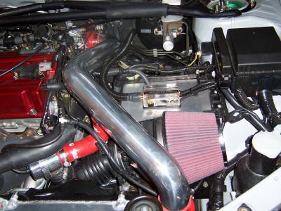

I had a hard time visualizing this kit on rmr's web site b/c they had no pictures on if in the car - BUT - Now that I have it - I was amazed how good it is - its a very well made and well fitting kit - have not driven it yet so no idea how much power if any it gains - BUT it does look nice

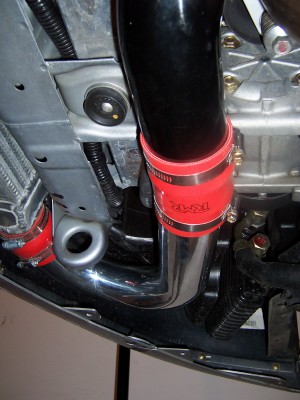

another

Nice. I am still trying to decide which pipe setup I am going to get, and the Buschur one seems to be on permanent "Coming soon" status.

Did it require the relocation or resizing of the battery for clearance? I know that Buschur's does.
I saw your trunk mount in your other post and just wondered it it was mandatory with the installation of the intercooler pipes.
Old Jun 5, 2003 | 09:25 PM
Alfriedesq's Avatar
Joined: Feb 2003
Posts: 1,690
From: Stamford, CT
NO - I think thsi would fit perfect with the stock battery - thats why it curves out to the head - - - I put the battery in the trunk a long time ago to help better balance the car and to make free up the engine comp

Just curious - did you remove the under-body splash for the pics only? I wondered whether the shields still fit with the new pipe.
Looks good though, how difficult was the install?
-Josh
Old Jun 5, 2003 | 11:28 PM
Alfriedesq's Avatar
Joined: Feb 2003
Posts: 1,690
From: Stamford, CT
-Josh
Its pretty easy - but I have had the bumper off like 5 times already so I have practice at it
I leave the under shields off as it makes it easier to strap it to the dyno - - BUT the pipe kit would fit fine with the stock under shields

It helped me in a few ways
1 - it makes the boost response more crisp and accurate - - the rubber hoses buldge out slightly as you come on boost and then contract - it makes your boost fluxtuate - with this pipe set that feeling is gone
2 - The factory pipe going past the air meter was not working very well with the samco hose I was usuing and the RMR air fikter this pipe kit resolves that issue as all 3 pieces are designed to wrok together
3 - I may want to mount a NOS fogger - - I need a metal tube to mount that in
4- Its a straighter line for the air - less bends - - it makes more power - also becuase its bigger
I like it
