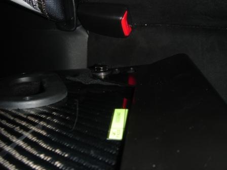

As far as the conidition of the seats the the carbon fiber overall looks really good. There a few areas where the weave was distorted to go around the curvature of the shell but they are minor. The clear coat on one of the seats is kinda hazy in an area the size of a pair a glasses (yeah, yeah i'm tryin hear). Whats kinda funny is that its right above the quality control sticker, lol. I just happened to catch it when the sun was shining off of the seats. it looks like there is also some light scratching or hazing along the back edge of the seat thats about 2" x 1/4". I am not sure if these are a result of shipping or not. The fabrics your standard microfiber in black and is very good quality. One of the seat back cushions has an impression in it possibly caused by something laying on it?? The high wear areas near the shoulders provide seem grippy but that beads look like they could come off with time.
The NRG seats come with brackets but when bolted to the seat the mounts arent planar. I am not sure if all side mount brackets are like this or not but i think i may be more of an issue with teh hold for the bolts on teh sides of the seats. One of the holes i had a tough time getting on of the included bolts into and i still can't get the bolt seated down far enough to contact the washer so i had to get another washer to make up for the gap.

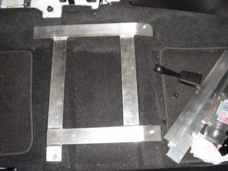

I hope the mounts not being planar doesn't cause too much stress on the seat once its bolted in. Ont he subject of bolting it in you can't bolt it down directly to the floor. There is too much curvature and the back two mounting locations are not position to make the square base you will need for mounting. I bought some 1/4" x 2" (i bought 1/4x1.5" but they deliverd the wrong stuff)" 6061 aluminum to make my mounts. I didnt buy mounts b/c I wasnt down with paying 200-300 bucks for about 50-60 bucks worth of metal. I dont think going with the 2" wide aluminum will be that bad though, probably will work out better. The estimated weight of the as shown in the pics below is 3.42lbs.

I'll take some more pics when the mounts are done so y'all can see how they fit. I think its gonna be really nice having the seats bolted directly to the frames. I didn't want to buy sliders yet b/c I'm the only one who drives my car and I'm on a budget. As for the passenger seat I am just going to mount it in a neutral location so an average person can get in the back seat or front seat. Additionally I wanted my seat as low as possible and I pretty sure this is as low as you can mount a seat without cutting up the floorpan.
