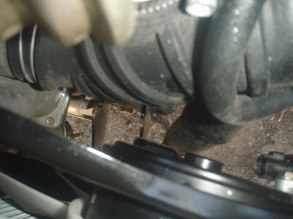

Hello Evo 9 owners I need you help, I got this Evo 9 from the auction and I am making list of parts that I need and I don't know what part are missing on that picture

the boost line to your waste gate from the solenoid...

undertray (get an aftermarket one), lines from turbo and to waste gate, and looks like a motor mount (get the Agency power one its strong and nice too!!!
and the entire mount assembly, that goes from the front to the back

all i noticed was the boost line from the WG

Motor mount and crossmember!! Jesus, where did you get your car from. Are you serious? They sold you a car like that?

the harness to the fan?

Buying this car in that condition and not knowing anything about them is not a good idea. If that picture is a sign for what the rest of the car is like, you have alot of work ahead of you. Your best course of action would be to find a shop or person that knows alot about the car and can go over it for you to fix everything before you even drive it. In the pic only a very simple wastegate vaccumm line is missing along with the motor mount. But that very simple wastegate vac line that is missing has been allowing the turbo to run max boost to the engine. More than likely there will some engine problems on the car.
