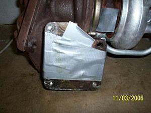

I wouldn't waste you time drilling or trying to extract. Just find some pro who can remove in a few hours and you can be on your way.
