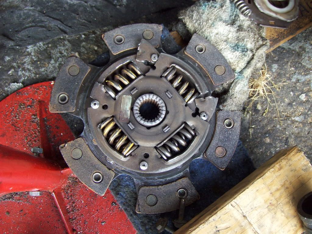

Originally Posted by bluebyu36
samething happened to me!fix it trust me.....
this happened because the trany was moving as i shifted...600 miles on this clutch
Same thing happened to me...bolt snapped and the transmission flexed sideways as I pressed in the clutch pedal. Did a high rpm burnout one day and BOOM, clutch disc exploded. The transmission bolts are VERY important, none should be left to chance. Any machine shop worth a damn could get the bolt out without destroying the threads, I've done it many times.
