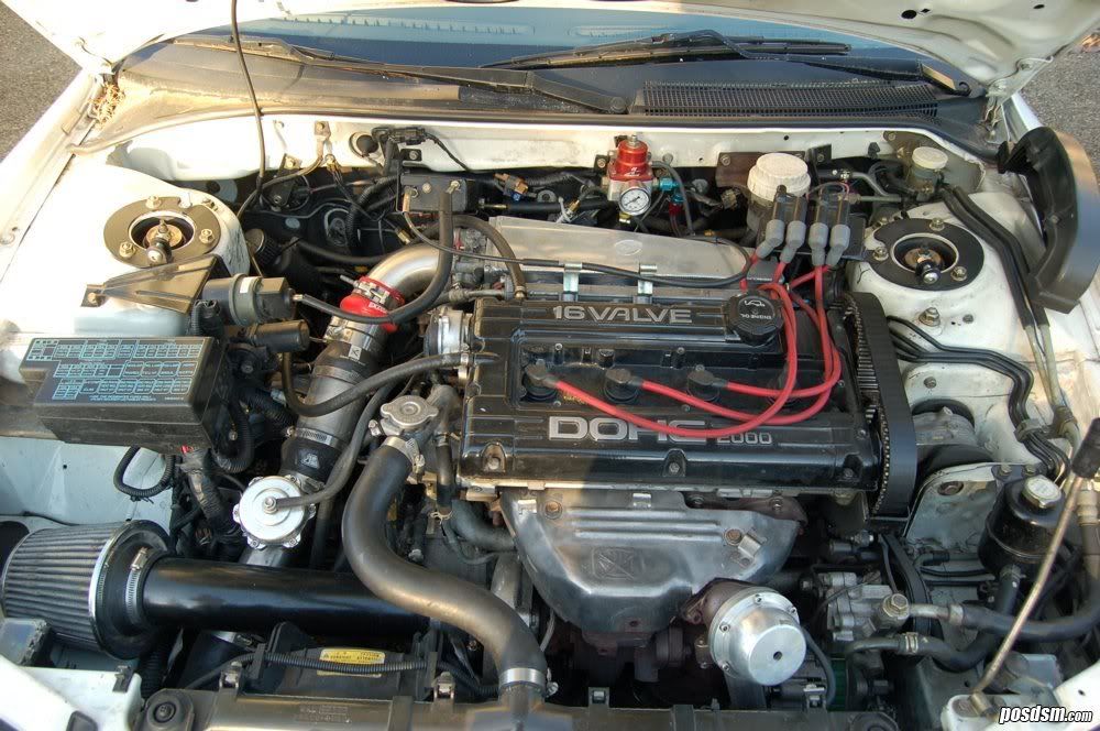

Why not look back to the DSM days and not try to reinvent the wheel?...
Stock manifold with WG flange welded on. It's been done to death on DSMs, and it'll work on EVOs too.
