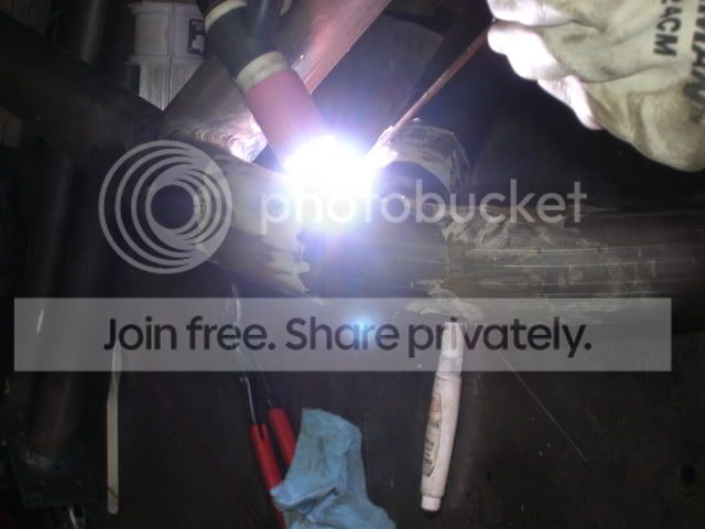

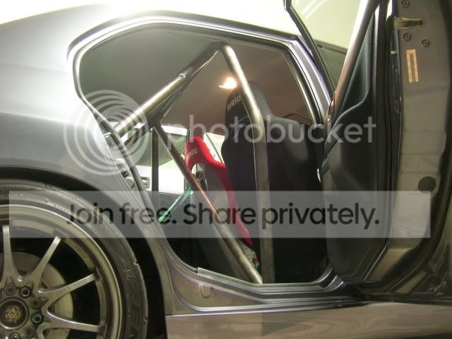

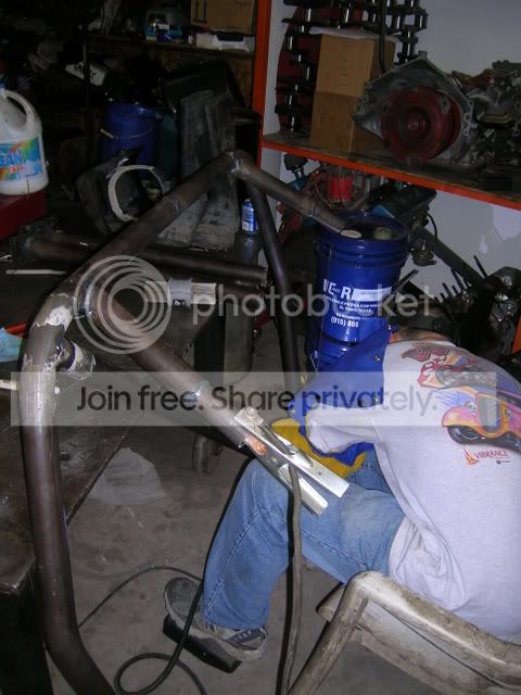

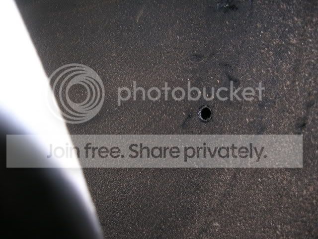

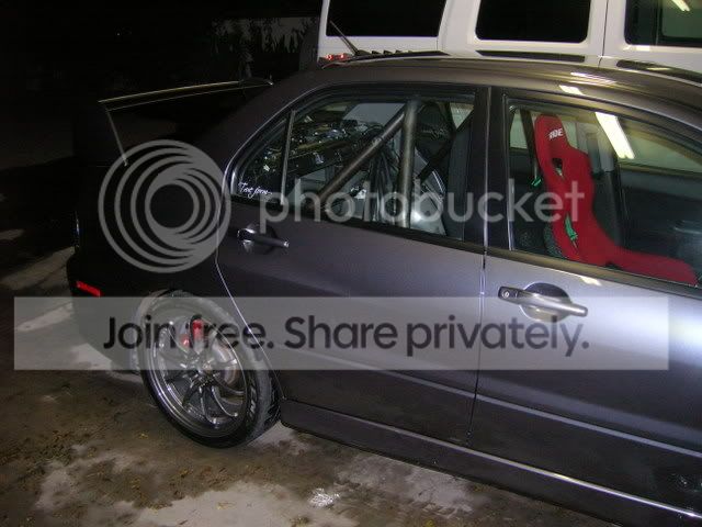

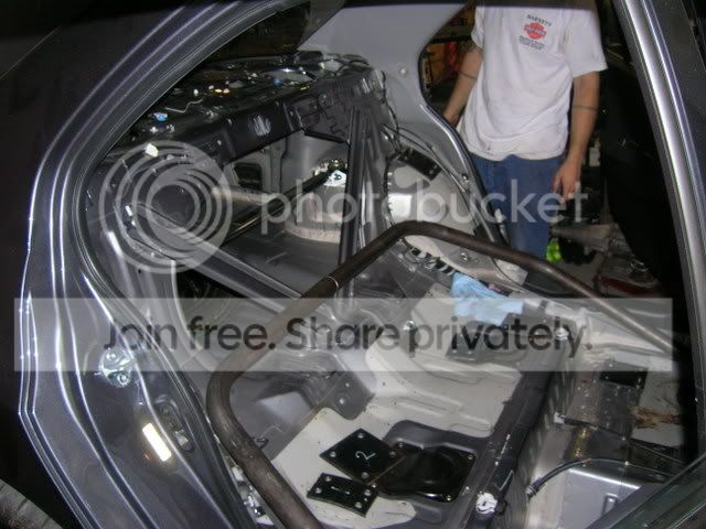

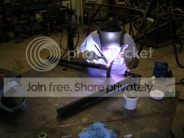

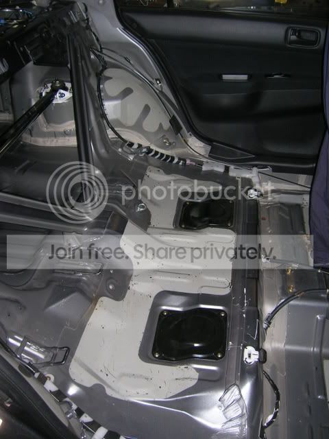

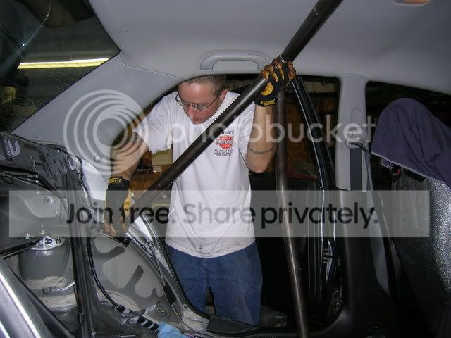

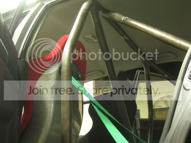

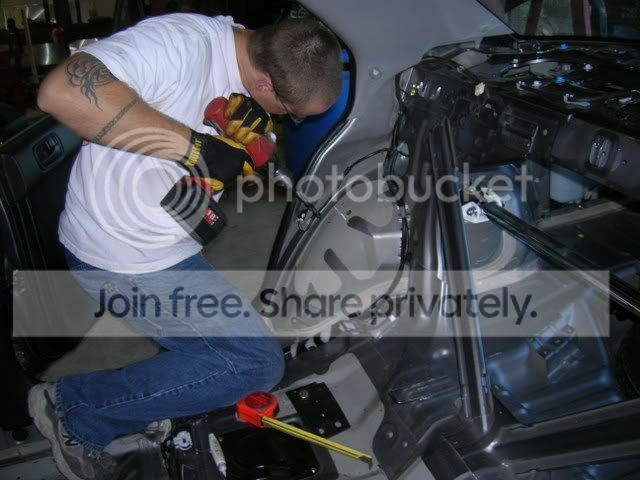

Long story short I was going to purchase an Auto Power roll bar for my car and I got to thinking that my friend could easily replicate the Auto Power unit for a 1/3rd of the cost. He and I built a cage for my Spec Miata about 9 months ago, this was a full weld in 6 point cage. So a 4 point bolt-in must be easy It took us two night to build and roughly $140 in materials ( I still have 20 ft in material left). I went with 1.75 DOM tubing. All the bars were TIG welded aswell. The roll bar doesn't have a harness bar yet....I am debating whether or not I want one. It is going to be pulled out in a couple of weeks and painted (my friend also paints on the side). So here you go. I imagine there will be some interesting comments. The roll bar debate always creates arguments. Fight nicely please.

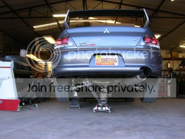

My Miata for reference.
Virgin rear...
It has been penetrated
Fast forward....Main hoop bent
rear legs
Tig yo!
Lookin sexy
Almost done...
The mantis loved teh Nardi
and donzo.

why the mix and match seats? Hiz and Herz?
