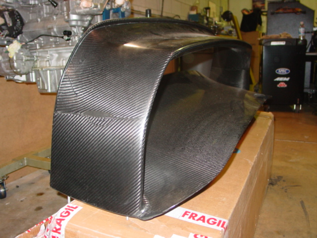

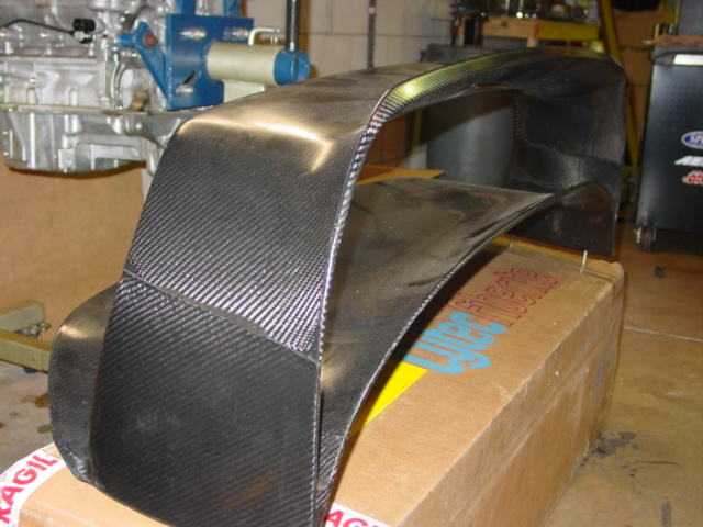

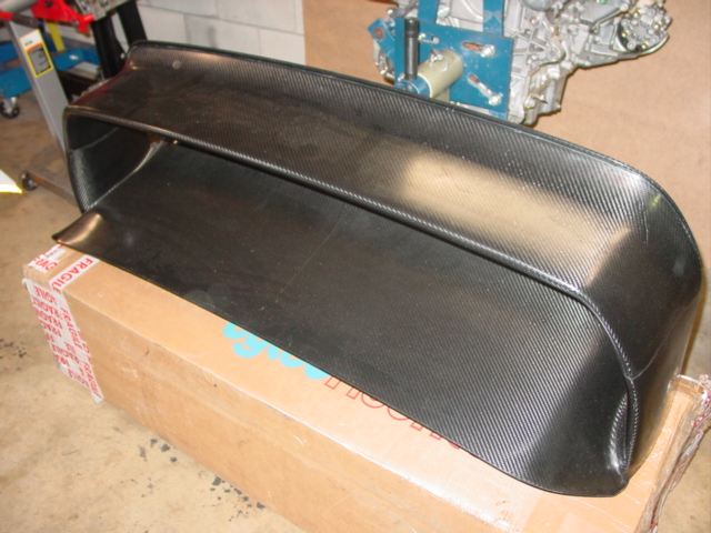

This is from a shop here in ILL
Real WRC EVO wing pictures
Thought some of you might find this interesting. Don't ask how or why but we have a real full Carbon Fiber WRC wing from Mitsu's last factory backed WRC effort.
Developed in Europe by SPA Composites for Mitsubishi. All I can say is holy downforce!!!!!
It weighs in at a scant 5 lbs and is stronger than any other wing I have ever seen.
Price is, well, if you have to ask you probably can't afford it. Only a mind boggling $11,000.00!!!!!!!!!!!!!!

$11000... i dont know how they justify that price.
Because you can buy a 600 hp eclipse gsx for that money. Or you can change almost the whole car out, to carbon fiber.

I dont think you know how long it takes to make one. Thats why it so costly. Plus all the R&D that went into it.

Because it is real autoclaved carbon work with real aerodynamic testing, not some half *** wet layup on top of fiberglass like 99% of aftermarket crap and some guy guessing it will make down force.

Well you can go for looks but if you rally your car and have rules similar to what drove the production of this wing then I would go for function. I agree with the post on a previous page about the design being rule driven. For the money a large wing that is high and further back will get you better rear downforce results. One good thing of this wing though is since its location is closer to the rear axle it will cause less lift on the nose than a huge wing that is farther aft so that means less up front to balance out the aero on the car.
