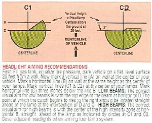

Yes, from the factory they are aimed too low. The manual headlight adjustment knob is for load compensation. If you fill the trunk with luggage and have four people in the car, the headlights will be pointing at the sky. It is easy to adjust them how you want them though...

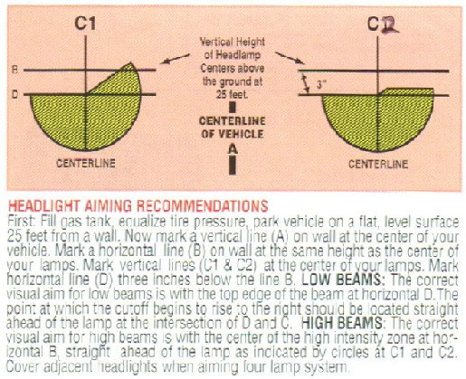

I'm glad this thread was brought up. I too have noticed the lights are just too damn low from the factory and after this thread reminder I'm going to adjust them tonight. For those who need a little guidance as to how to aim the headlights I will attach an illustration showing how they should be alligned and not glaring in anyones eyes.

can anyone explain this better... the pic by evo8 kinda is hard to tell... all i want is my lights like 2 clicks higher on our beam switch....

You can use a T25 Torx bit somewhat, in the hole onthe opposite side of the gear. The gear is basically 2 sided. Any small flat screwdriver can work too.
Best thing to do is line up to a wall or garage door and just mark where you are and then adjust them to where you want them. You are supposed to do it at 25 feet.
Oh and the adjuster in the car was designed for whwen you had a load in the car, you could lower the light back down.
