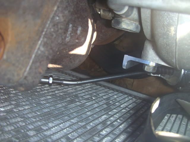

i have having boost problem's ever since i installed the forge wga the car has a lazy spool,but over boost with the boost controller turned all theh way down i get 27 28 pounds then tapering very fast up top to maybe about 19 psi,this is a bran new forge wga,and a bran new boost controller i know it is hard to tell from pics,but is this adjusted wright:
thanks for your help this is driving me crazy

What kind of turbo are you running? How much pre-load is on the wastegate?

Did you adjust the actuator rod's length so that it just slips freely on and off the flapper valve's pivot arm?
Old Nov 25, 2007 | 09:54 PM
bluebyu36's Avatar
Posts: 2,669
From: new york
there was a little tension

I had the same issues at a Dyno Day this spring. It turned out that there were 2 issues. 1) I had bent valves, screwing with my psi build up, 2) the spring in the wastegate was rated between 21-25 psi.

are you sure you just dont have too much pre-load on the wastegate?
