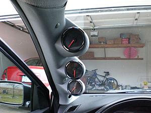

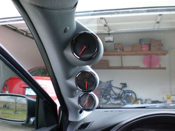

They did a good job on the gauge pod install, but messed up the tweeter cover, and the sensor they put in the exhaust manifold is pretty shoddy workmanship in my opinion. Oh well, chalk it up as a lesson...
Attached Thumbnails Punctured Radiator...-cimg0787.jpg   Punctured Radiator...-cimg0791.jpg
