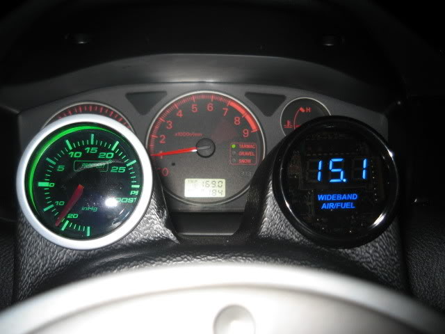

prosports and LC-1 wideband. Defi gauges are overpriced.
I have a similar setup except I have the Stewart Warner boost gauge on the right and the red DB on the left. The only downfall is it is difficult to see the fuel gauge but I just judge when it is time to fill up based off of the mileage and then confirm it with a peak around to the fuel gauge.
