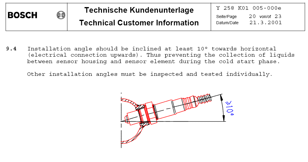

Bosch recommends >=10*.
i mounted mine at -15*. condensation may shorten my sensor life.
