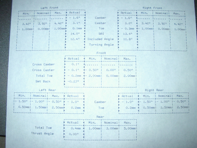

Looks like a good alignment. Since you were asking about mine earlier, here it is:
This was performed with me sitting in the driver's seat. I understand my slight toe-out in the rear helps the car rotate better in the tight auto-x situations, but my front toe being uneven concerns me a bit so I might get that looked at. Also, I'm wondering if caster is adjustable as I would like to run a bit more to help the car track straighter and increase steering weight.
