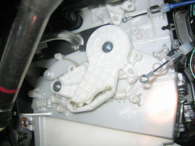

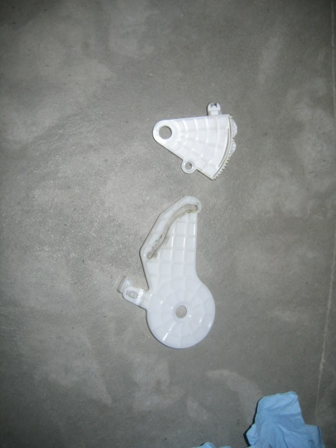

So I broke my knob and got the replacement parts from the dealer.
The Link heater control (plastic gears) PN is 7801A110 costs less than $20 at the dealership (pics below)
The Controller assembly I got was actually for the standard Lancer, PN is MM185137HB. This unit costs a little less than the actual Evo unit, only difference is the grey trim peice that goes around your radio/HVAC controls. Everything else is the same, just use your old grey trim.
So if you broke your knob, get the standard lancer controller assembly and save a few bucks.
If yours is just sticking, buy the plastic gears and save yourself some significant coin in the long run.

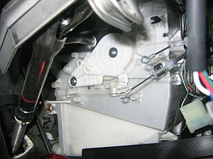

I had a printout of the TSB and dam was that complicated. Instead I just removed the plastic trim under the steering wheel, cubby under radio and everything's straight forward (awkward trying to get to it but straight forward).
Took about an hour total.
HTH
Left to right:
Original installed, I can see how this is a bad design.
New gears
New gears installed
