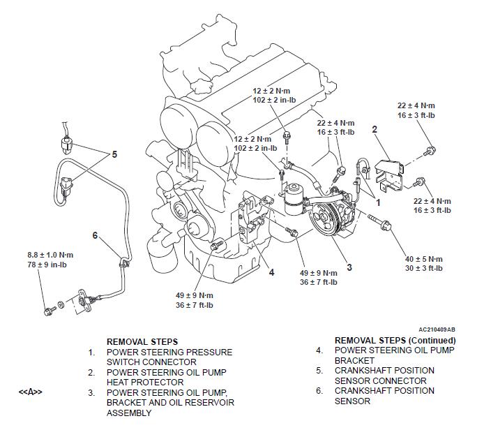

Yeah it sits next to the intake manifold you can see how the wire goes for item 6.

Okay so i unplugged item five to measure with a volt meter cuz i wasn't positive where the crankshaft position sensor was. i checked all the plugs and found 10v and 5v. the 10v isn't that weird cuz now my battery is reading 10v at the terminals. it was reading around 12v a few days ago. but i didn't seem to get any resistance but I'll check it again tomorrow. too late tonight to check it again.

No just ohm out every combination of prongs on the sensor plug (from the sensor) as shown on item 5 on the bottom. One combo of the 3 prongs should ohm out to like 6 ohms or so it doesn't really matter what it ohms to just as long as its not OL.
