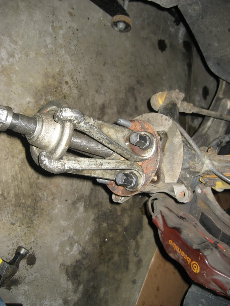

Have you tried one of these? It should push the axle right out.
I'm having a ***** of a time getting the hub off, but you shouldn't have to worry about that.

Originally Posted by SeeCoryRun
if you remove the lower bolt retaining the balljoint it will allow you to pull the knucle back enough to slide the axle out
Yep
If it doesn't slide right out, odds are the splines are F'd. I would use the tool above (of course you took the castle nut off)
