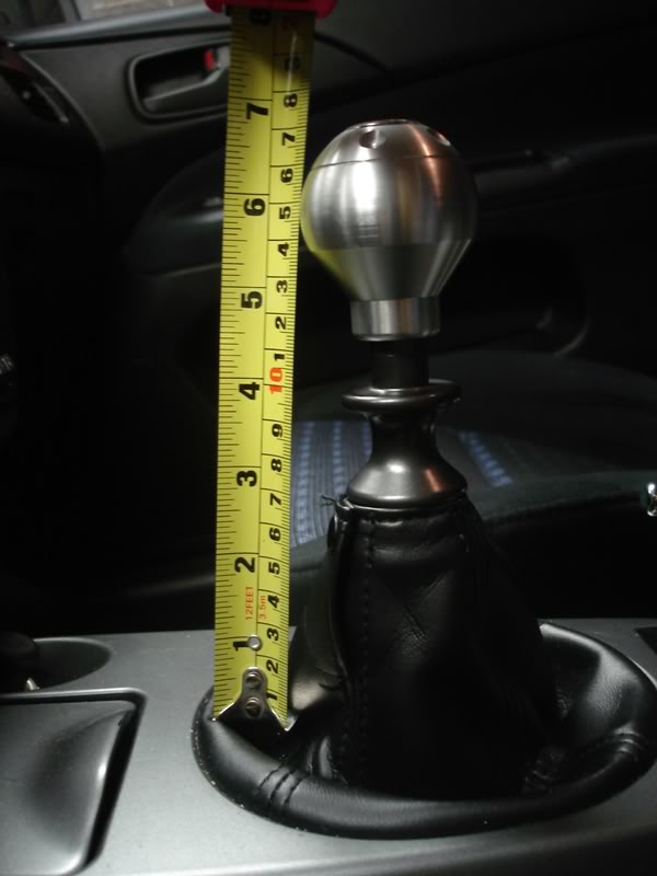

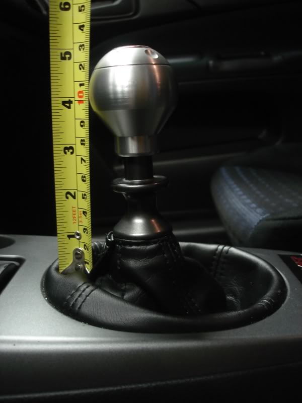

Just make sure to put it back together perfectly in line or it will bind, causing the lock out lever to stick. If you do it correctly, it will provide years of perfect operation.
You pretty much have to use the stock setup. Machining of a new lock out lever was going to run me around $500, just for the lever! Where the two pieces slide into each other was the main reason for the high cost. Those two parts have to mate perfectly.
I've done about 10 of them so far locally and to my knowledge all of them are still working perfectly.
I had to shorten mine. I'm 5'11" and have an upright back rest preference. Every time I would shift into 2nd and 4th, my elbow would hit the side bolster. Drove me crazy! Everyone I let drive me car loved it and it just went from there.
Make sure you buy a few spares. If you mess a part up it's not like you can get one from Mitsu. You have to buy the whole assembly!
