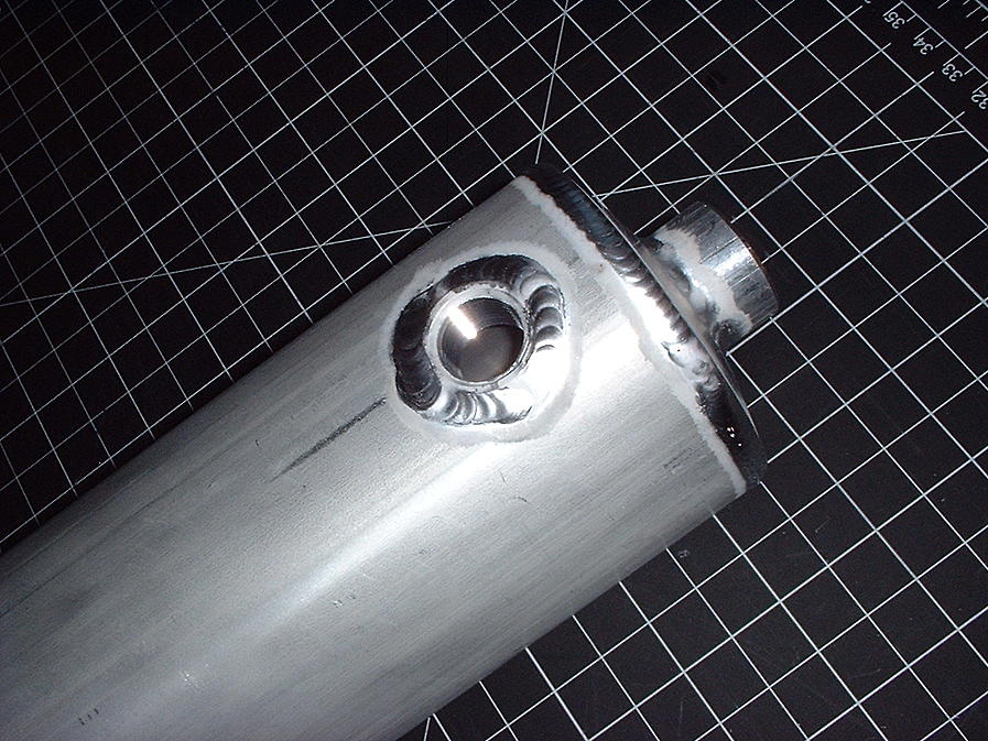

comment on 06MRV8Killer post
I am concerned about what 06MRV8Killer said about AWDMotorsports saying the Greddy is not doing anything.
Anyone else, had any thoughts on this?
I looked into the: http://www.saikoumichi.com/SPLIT_DC3_page.htm
Other than the price, I think I will go with this one. I emailed him and he said he can do powdercoated colors and bare aluminum. I like the red!
Attached Thumbnails Is catch can need when upgrading to GT35R and does it matter which one?-red-finish-dc3.jpg   Is catch can need when upgrading to GT35R and does it matter which one?-bare-al-sample.jpg
I wouldn't say that the Greedy Catch Can isn't doing anything, but it isn't the best choice. A catch can with baffles/filtering media like the Saikoumichi or JCS Automation will do a much better job. I've had both types and the baffled/filtered can will collect much more oil.
