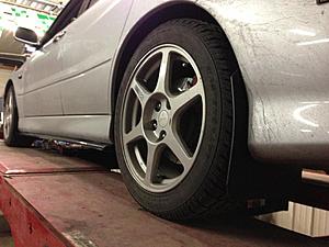

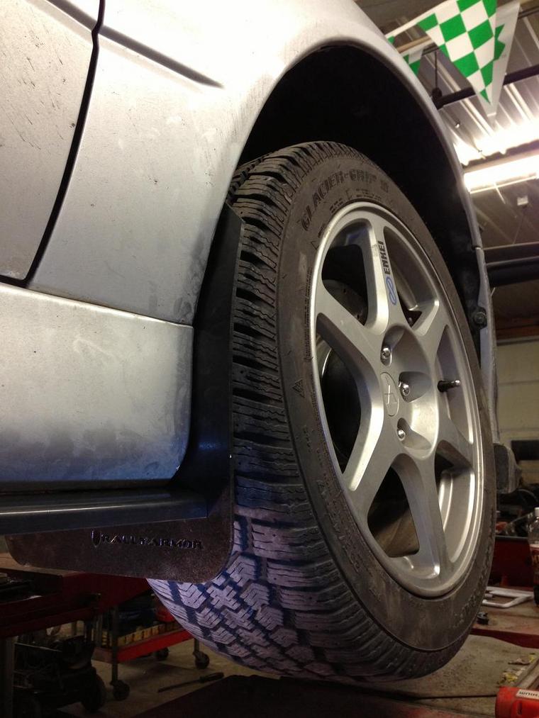

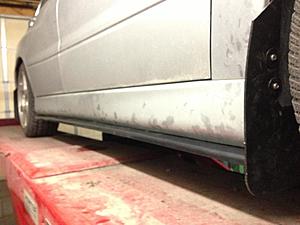

Bayson R side skirt extensions and Rally Armor mud flaps INSTALL PICS

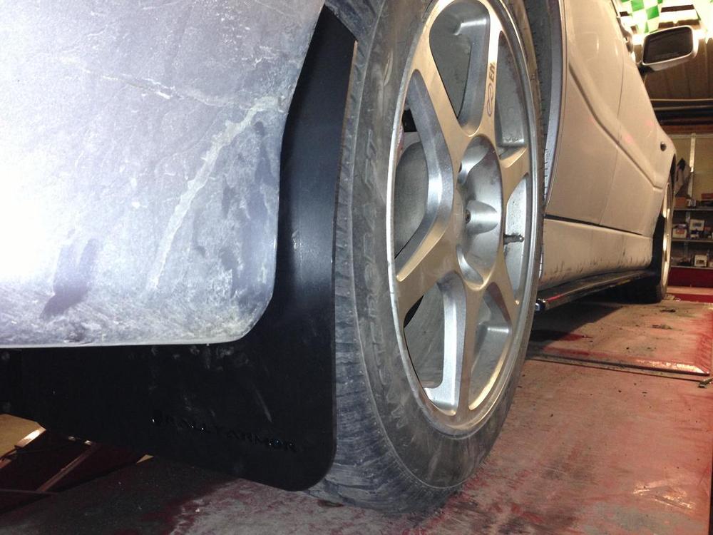

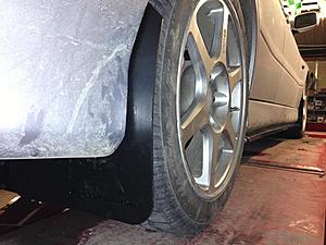

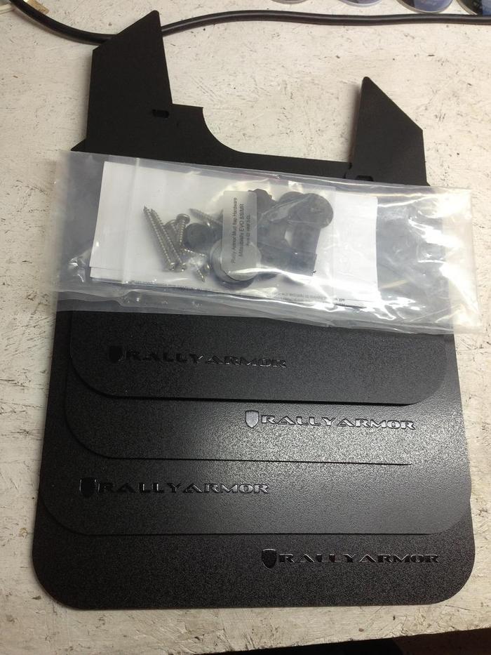

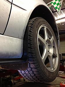

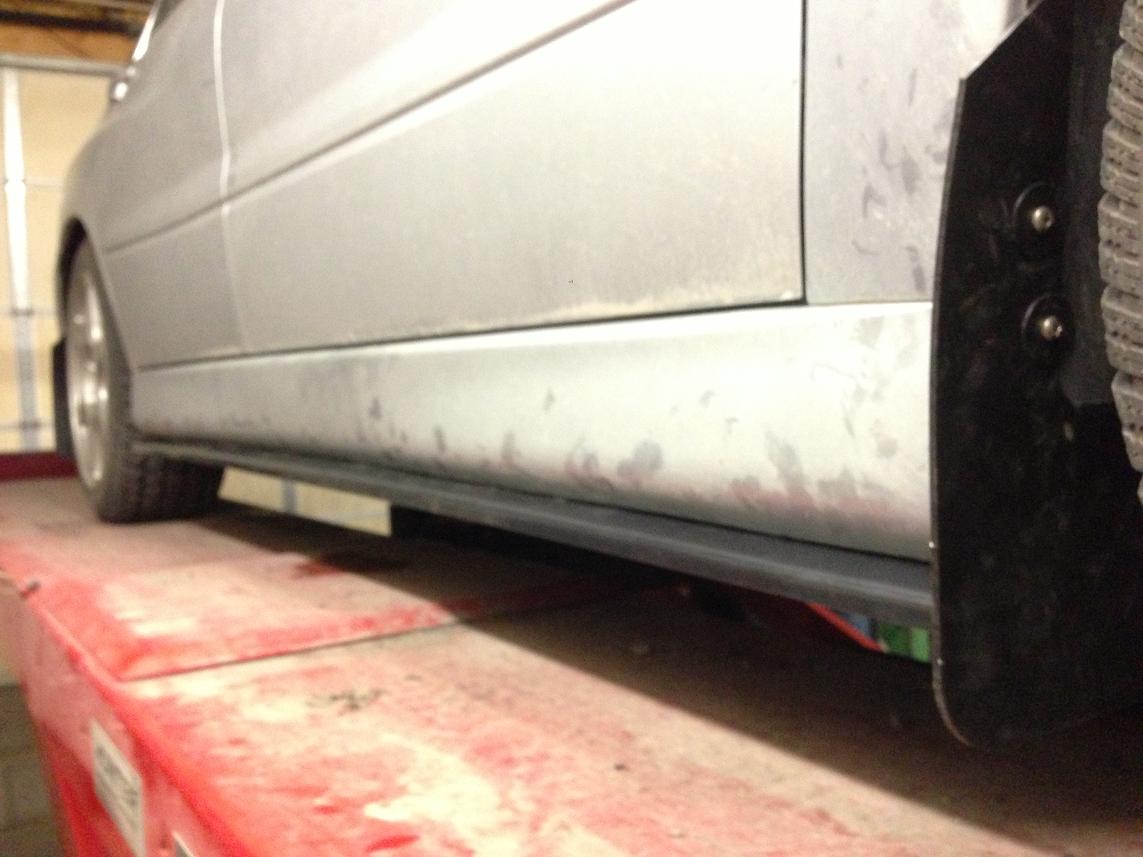

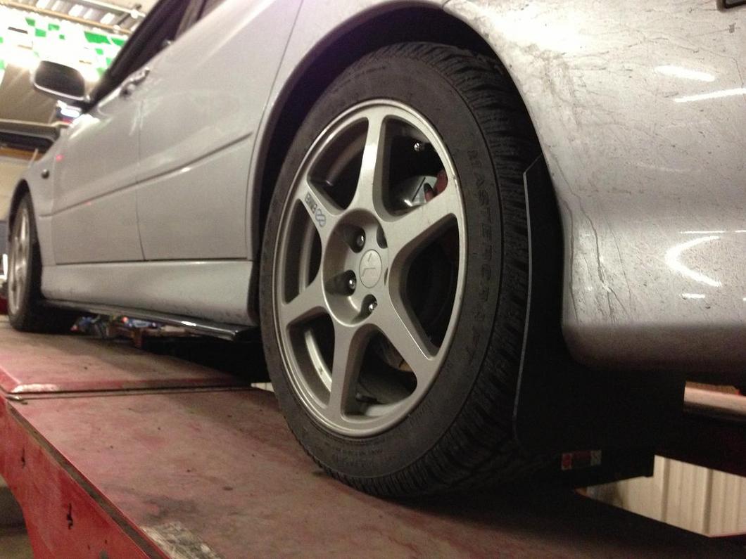

Ok guys I installed the Bayson R side skirt extensions and Rally Armor mud flaps on the lift last night and the install went well overall.... it took a bit of finagling to figure out which side is which with the side skirts, but the shorter part on each front side of the extensions that you screw into are the parts that goes towards the front (if that makes any sense just look at them and u will see it). The self tapping screws worked great that were included in the kit.
Bad news is that if you want to install mud flaps at the same time you have to install them first and then cut the front part of the sideskirts to get them to fit cause otherwise the backs stick out far enough to cause an issue with the tire or debris that can cause it to be ripped off. It was easy to cut with a cut off wheel and you cant even tell it was cut at all because the front mud flaps are flush against it on the front. They do look good though with everything installed! Hope this helps you guys. Let me know if you have any other questions. Thanks
