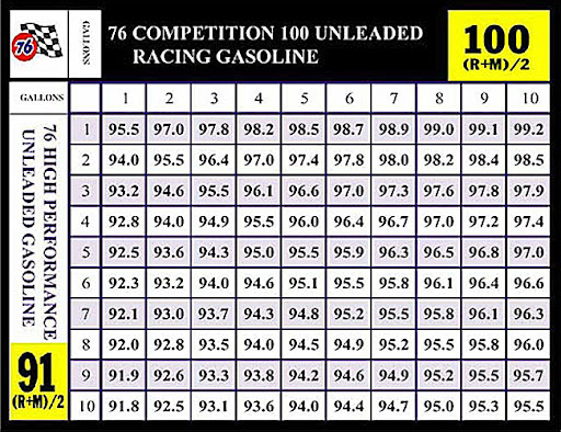

Another option would be to use 100oct. Gas, and mix down to 93oct. Cali only sells 91 at most pumps, but there are a few that sell 100 VP at the pump. I mix that down to 93 and my car runs better. Evo 8s were designed to use 93 from the factory, not sure about 9s.
http://i483.photobucket.com/albums/r...91OctLarge.gif
N

Mix chart for 100/91

Edit- Wherever you got that mix chart, it's far from accurate. I know from racing MX that 1 gallon of 110 and a gallon of 91 only amounts to about a 93 octane mix. It's far more complicated than that chart shows.

[QUOTE=
Edit- Wherever you got that mix chart, it's far from accurate. I know from racing MX that 1 gallon of 110 and a gallon of 91 only amounts to about a 93 octane mix. It's far more complicated than that chart shows.[/QUOTE]
http://www.motortrend.com/roadtests/...h_octane_fuel/
Here is an alternate mix chart for 91/100.
http://www.rockettbrand.com/techsupp...ndingChart.pdf
N

I guess I either mis understood what I was told or the guy was talking out his ***. Thanks for clearing that up for me.
