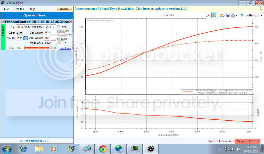

stock
bc272

So BC cams are kinda a fail if you spend more then $200 bucks. If you get them for a deal like me eh idk if the work was worth 18 hp but the car def feels peppier. And it spools a lil quicker. So I guess it was worth it. oh and im a fat *** I do weigh 280 pounds and its a SSL

actually now that I look at it on a bigger computer screen these cams actually picked up quite a bit of bottom end compared to stock cams.

oh yeah for sixty dollars **** cant beat it. Im pretty happy. This was with no retune, Retuned it later on since its hitting higher load cells these aren't too damn bad. Was able to get 420 out of it. on 23 psi
