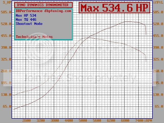

Originally Posted by Lancerboy89
Just giving my opinoin, Im running a BBK from CBRD and i love it, i know that this was not one of you options just thought a would add a third. Good luck
here is a BBK @ 31 psi:
Compared to my
FP Red @ 33 psi

[QUOTE=Zivman;9701000]here is a BBK @ 31 psi:
Compared to my
FP Red @ 33 psi
[/QUOTE
In res[ect thanks you for the dyno sheet comparison, I dont mind The BBK is a great turbo for what i do with my car lol
