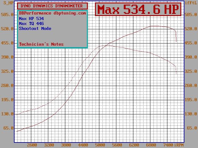

FWIW, here is my car with an FP Red
IX
Stock cams
3" exhaust
93 octane - limited to 26 psi
E85 - 33 psi
