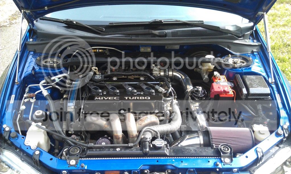

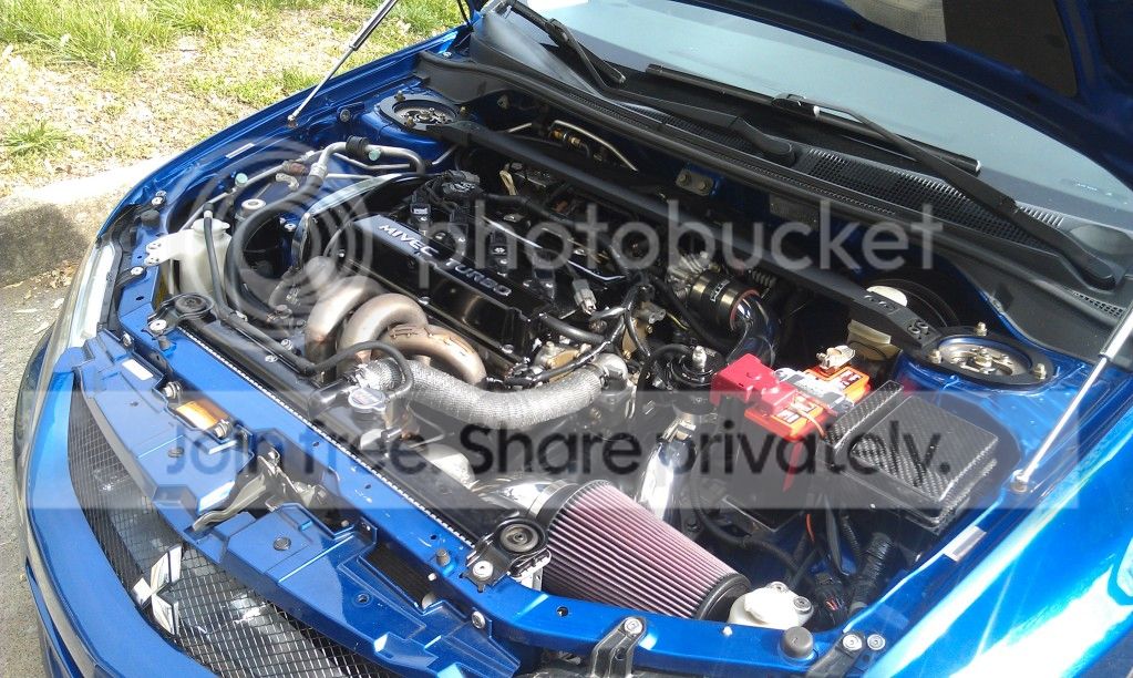

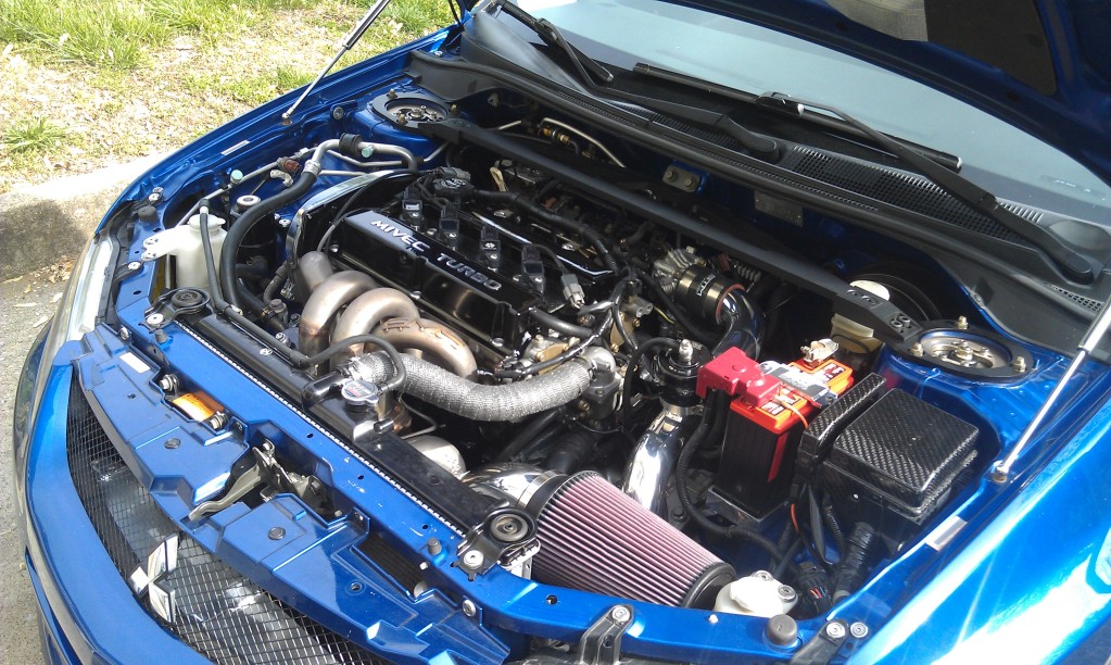

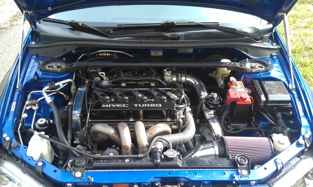

Make your own man. I bought a 4" 45* pipe, and a 4" 45* coupler, then threw a K&N long filter on it. I got $90 in it total. Nothing against the shops that sell these intakes, but man, they are way overpriced. My intake required no welding, just cutting of the pipe, and coupler if you wanna show more polished pipe.
