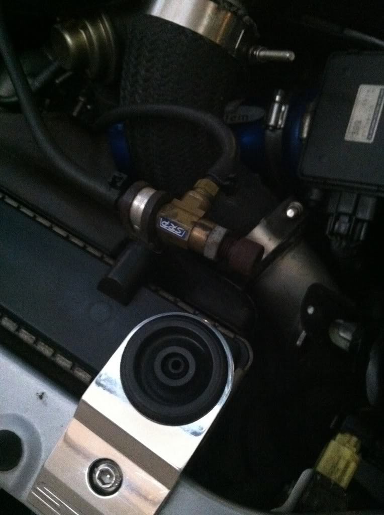

this is my mbc and to be honest im kind of scared to up or down the boost thats why i want some local builders or my dads friend whos a mechanic to do it the last thing i want is to allow more boost run lean and then yea..

i had the same thing.... check for a boost leak

Will that really cause me to make more boost though i dont get it??
