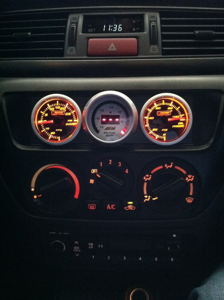

Originally Posted by deadstockkpomp
its a mbc but its a cheap one im pretty sure. im pretty sure im over boosting bc my gauge sits below 0 from the get go so its all making sense to me now.
when you mean your gauge sits below 0 from the get go, meaning when you boost wot the gauge dont move???, if thats the case then I would trace the vacuum line for the boost gauge and see if it popped off. If so then your getting a huge vacuum leak which might be contributing to your knock your experiencing. Check that first, as well as all your other vacuum lines. Go from there. Theres not many things that can cause knock, if it wasnt there before. If vacuum lines are ok, try turning your boost controller counter clockwise a 1/4 to 1/2 a turn, sometimes cold ambient temps can cause you to overboost. Thats why I swapped my dejon tool mbc, to a 3 port. That way the ecu has control of it, and can get around that kind of situations.
Old May 7, 2012 | 05:15 AM
deadstockkpomp's Avatar
Joined: Jul 2011
Posts: 611
From: Staten Island
no the gauge reads boost i think its off a bit though take a look where it sits, im reading about 24lbs of boost with the gauge like that when im tuned for a solid 23 lbs. so yes the gauge works it properly i just think its a little off on boost. im looking to go to 19 or 20 to be safe i dont track the car and im not a show off so ill see how it goes
