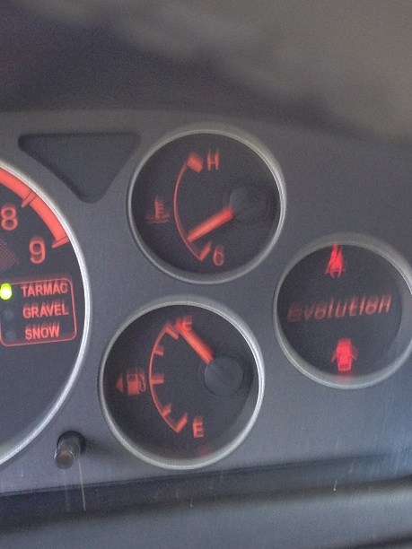

this is the "temperature" when it sat for more then 12 hours over night, wondering if it really isnt even over heating, maybe just a messed up gauge, and how could i check?

Gauge looks stuck

Run a ground directly from the batt ground to the gauge ground. It's on the valve cover closest to the BOV. See if the stock gauge behaves normally. I'm wondering if your fan might be the thing making the noise.

The noise has stopped, so it may have been a coincidence...but it's like stuck at quarter way when cold, then when warm (running temperature) its spiked to the H...I wonder if my system that is running off the battery has anything to do with it?

No, it will start to go up as I just let it sit there idle, I try to stay out of the turbo period when I was testing ye over heat...I feel like it may be just the gauge, but I will know shortly

Thank god it was just a bad sensor, thank you guys for al your help, I'm glad you were all wrong! Haha
