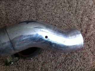

Got bored and decided to clean my intake pipe and found a hole on the bottom. It looks manufactured, however, I have never seen holes in intake pipes before. Wondering if I should plug it up or leave it uncovered. In input would be appreciated. Tried searching and came up with nothing.

Heres a pictures

Old Jan 22, 2013 | 12:06 PM
evodriver49's Avatar
Joined: Apr 2010
Posts: 289
From: SoCal
no need to worry about that, most intake hardpipes like that of the AEM or injen for example have that lil nipple or hole that wont affect the car in any way, i keep mine plugged up but my tuner said it doesn't affect anything but told me to plug it up to be safe.
Old Jan 22, 2013 | 12:13 PM
tntdsm's Avatar
Joined: Aug 2012
Posts: 40
From: Missoula
Ok, I will probably go ahead and plug it as well. Doesnt seem beneficial in anyway. Unaccounted for air would be able to enter the system from this area, so it would be the best idea to plug it. Thanks for the input
Old Jan 22, 2013 | 12:16 PM
Xplosiv's Avatar
Joined: Nov 2012
Posts: 156
From: Oklahoma City
Are you running a MAF still? Is the hole before or after the MAF? If its after the maf id be inclined to plug it since air after the maf can mess with AFR's.
Old Jan 22, 2013 | 12:19 PM
tntdsm's Avatar
Joined: Aug 2012
Posts: 40
From: Missoula
Still have a maf. Thats why I was worried when I saw it.
Old Jan 22, 2013 | 12:27 PM
Locdizzel's Avatar
Joined: Apr 2009
Posts: 246
From: Frederick, MD
it runs to the OEM boost controller, when i switched to the GM EBC i covered it up

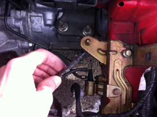

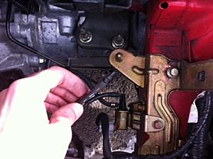

Old Jan 22, 2013 | 12:39 PM
tntdsm's Avatar
Joined: Aug 2012
Posts: 40
From: Missoula
ok so, went out there to look around and found this. Dont know what was going on with the previous owner. The plug at the end doesnt fit in the hole well so I would have to get another adapter. Should I plug it up still or reattach it? car is running at a pretty solid 17psi, and creeps up to 20 in the cold.

Old Jan 22, 2013 | 02:40 PM
Ryuartz's Avatar
Joined: Feb 2010
Posts: 247
From: No where
Is your idle ok? Mine was horrible when it was unplugged. It probably messed up the maf reading. To be safe side, i would recommend you to find small rubber gommet and plug back in.
