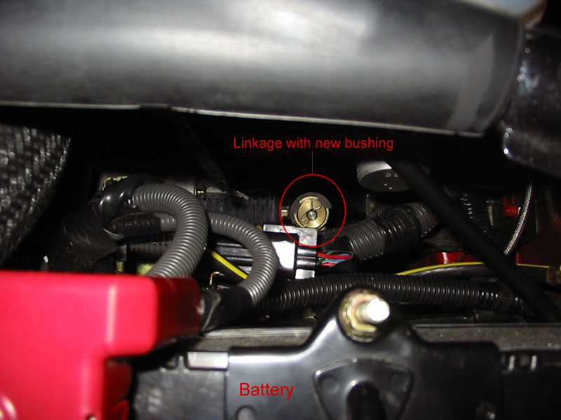

Could someone post pictures of this install. I just compleated install of a perrin short shifter and the metal shifter bushings that I purchased from Lancershop.com. I am considering the under hood kit, but would like to see how difficult it is to install first. Thanks

Well I didnt get any pics of the install but here is a pic of where this linkage is located. The reverse linkage sits below the one you see and is turned sideways. The reverse bushing doesnt need to be installed but it will give reverse gear a better feel.

I was actually waiting a review on those mods and now ready to buy them.
thanks for the pic also
