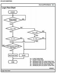

DTC SET CONDITIONS
Logic Flow Chart

if you need a copy of it i have a alldata access so i can email you or message you its like half of it

DTC SET CONDITIONS
Logic Flow Chart

- Intake air temperature sensor failed.
- Barometric pressure sensor failed.
- Use of incorrect or contaminated fuel.
- ECM failed.
DIAGNOSIS
Required Special Tools:
- MB991958: Scan Tool (M.U.T.-III Sub Assembly)
- MB991824: V.C.I.
- MB991827: USB Cable
- MB991911: Main Harness B
STEP 1. Check for exhaust leaks.
Q: Are there any abnormalities?
YES: Go to Step 2.
NO: Repair it. Then go to Step 14.
STEP 2. Check for intake system vacuum leaks.
YES: Go to Step 3.
STEP 3. Using scan tool MB991958, check data list item 12: Volume Airflow Sensor.
CAUTION: To prevent damage to scan tool MB991958, always turn the ignition switch to the "LOCK" (OFF) position before connecting or disconnecting scan tool MB991958.
