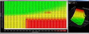

Car still needs some tuning love, but over all it runs pretty damn smooth. The idle will dip really low still, when turning into a driveway. Need to adjust some of the idle settings a bit more for that. The ignition map also needs more work, but for now car is running about 25psi runs pretty strong on e85.
Attached Thumbnails Finally got me an AEM Infinity for the Evo-idle.jpg   Finally got me an AEM Infinity for the Evo-ignmap.jpg
