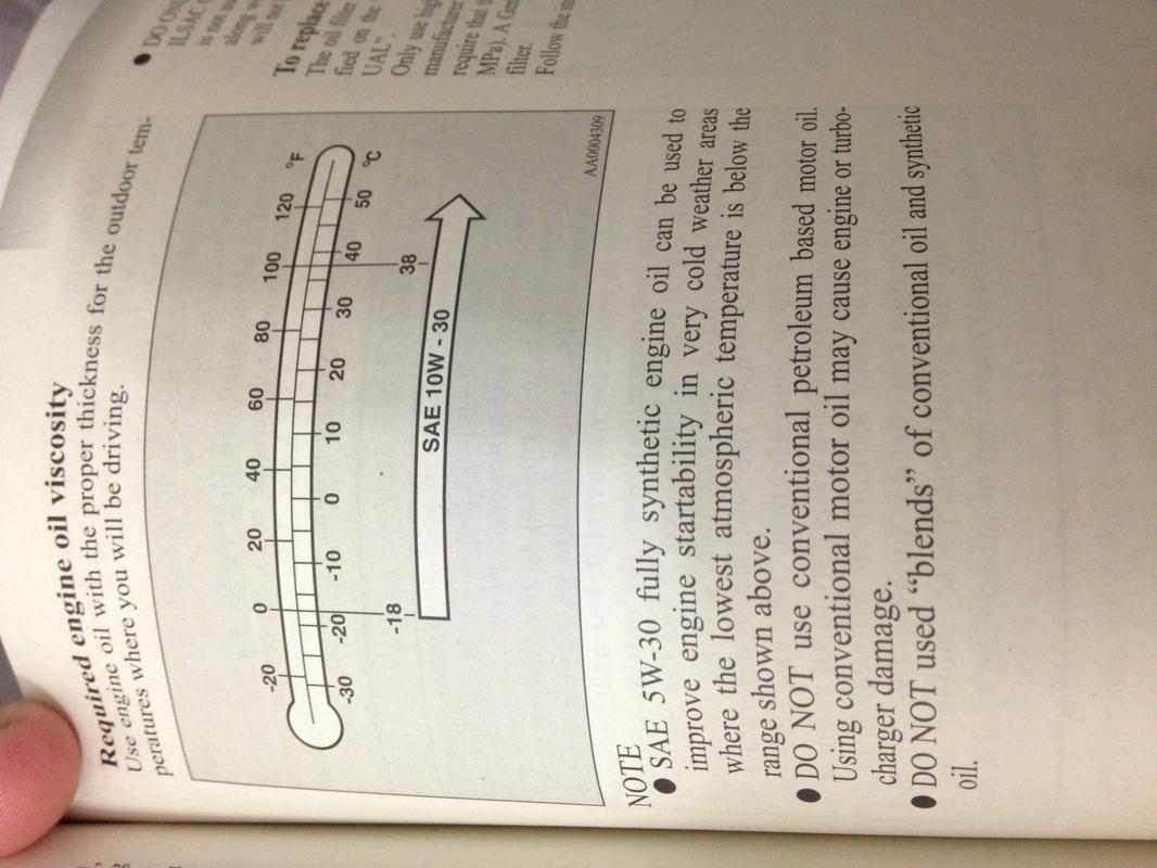

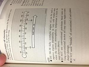

I found this in the Manual stating do not use conventional oil.
